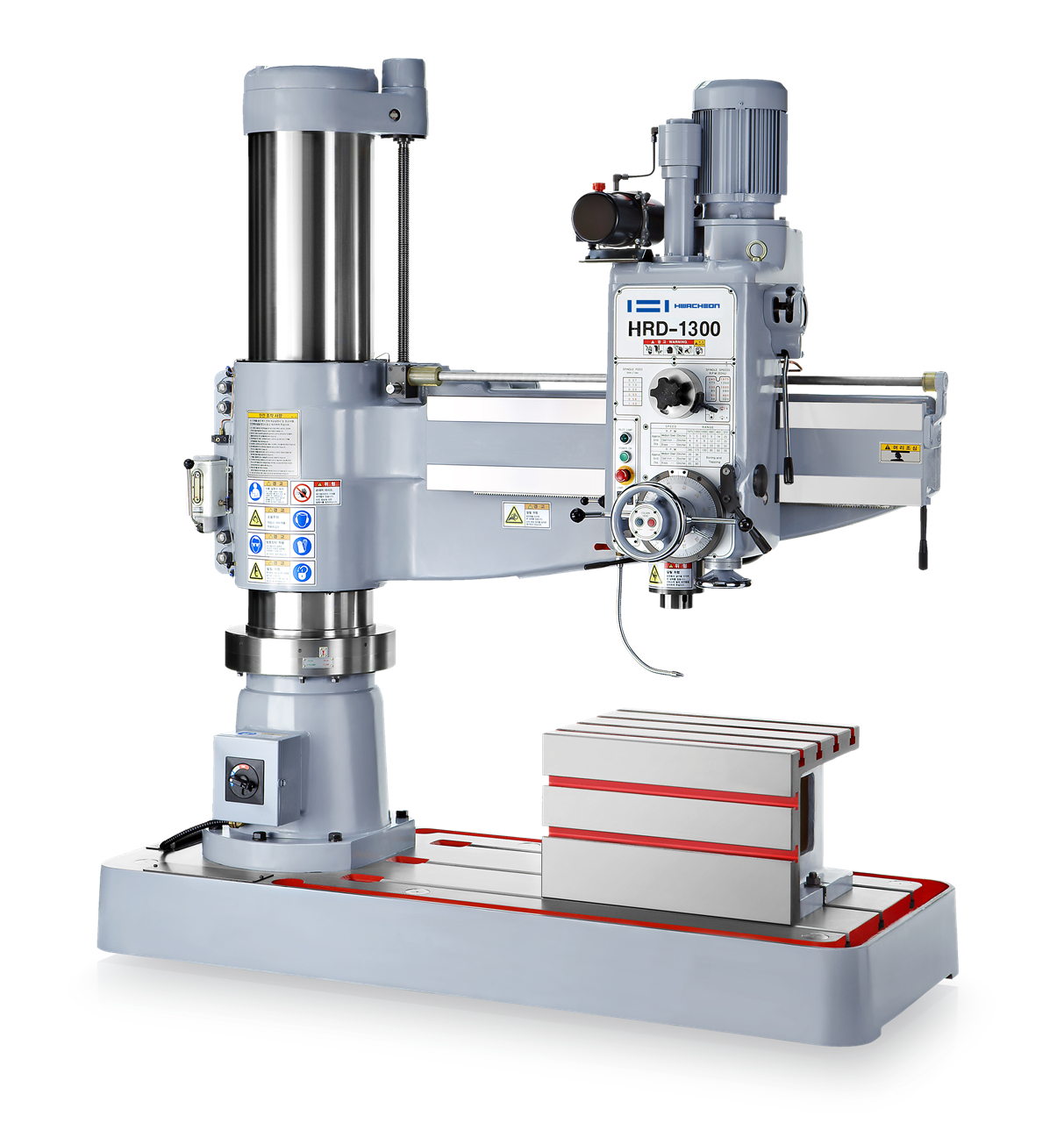

General - HRD-1300
HRD-1300
Radial Drilling Machine
HRD-1300 ensures high precision and rigidity based on a heat-treated rigid machine structure.
User convenience has been maximized for easy and convenient use of the machine.
