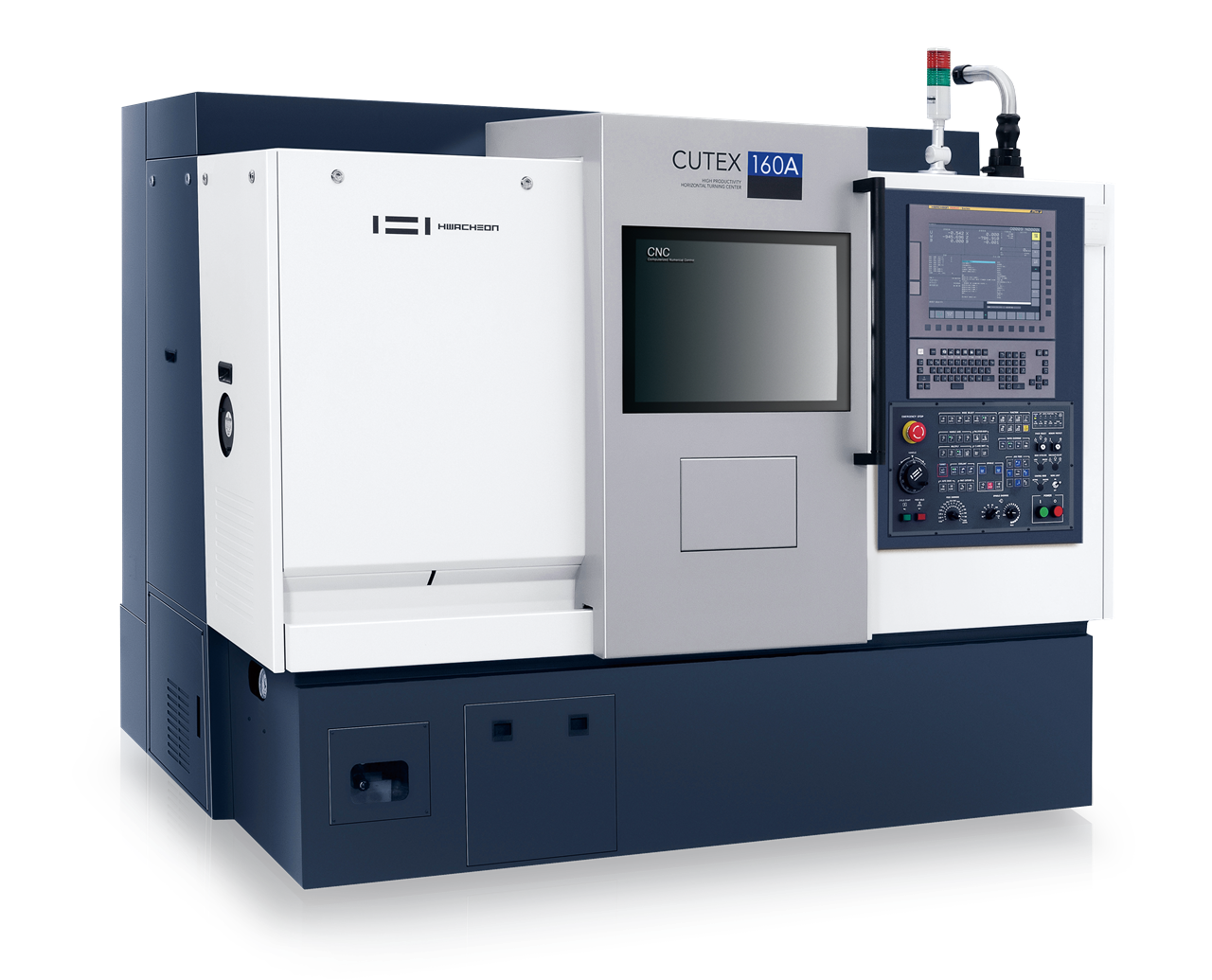

CUTEX-160 maintains high precision even during long-term processing by minimizing thermal displacement based on a rigid construction and compact structure.
Hwacheon software installed on the machine improves productivity and precision, provides better machining quality compared to existing machines.
Item | CUTEX-160 | ||||
CUTEX-160A | CUTEX-160B | CUTEX-160A MC | CUTEX-160B MC | ||
Capacity | |||||
Swing over bed | mm | Ø550 | Ø550 | Ø550 | Ø550 |
Max Cutting Diameter | mm | Ø300 | Ø300 | Ø260 | Ø260 |
Standard Cutting Diameter | mm | Ø186 | Ø186 | Ø204 | Ø204 |
Max Cutting Length | mm | 300 | 284 | 225 | 209 |
Chuck Size (Main) | inch | 6 | 8 | 6 | 8 |
Spindle | |||||
Type of Spindle Nose | ASA | A2-5 | A2-6 | A2-5 | A2-6 |
Max Spindle Speed | rpm | 6,000 | 4,500 | 6,000 | 4,500 |
Through Spindle Hole Diameter | mm | Ø56 | Ø62 | Ø56 | Ø62 |
Max Bar Size | mm | Ø45 | Ø51 | Ø45 | Ø51 |
Spindle Bearing Inner Diameter | mm | Ø90 | Ø100 | Ø90 | Ø100 |
Spindle Motor | kW | 15 / 7.5 | 15 / 7.5 | 15 / 7.5 | 15 / 7.5 |
Turret | |||||
Number of Tool Station | ea | 12 | 12 | 12 | 12 |
Tool Size (Out Dia x Boring bar size) |
mm | ◻25 × Ø40 | □25 × Ø40 | □25 × Ø40 | □25 × Ø40 |
Turret Indexing Time | sec/step | 0.15 | 0.15 | 0.15 | 0.15 |
Axes | |||||
Rapid Traverse (X / Z) |
m/min | 36 / 36 | 36 / 36 | 36 / 36 | 36 / 36 |
Max. Stroke (X / Z) |
mm | 170 / 335 | 170 / 335 | 170 / 335 | 170 / 335 |
Feed Motor (X / Z) |
kW | 1.8 / 1.8 | 3.0 / 1.8 | 1.8 / 1.8 | 3.0 / 1.8 |
Tailstock | |||||
Quill Diameter | mm | Ø60 | Ø60 | Ø60 | Ø60 |
Quill Stroke | mm | 80 | 80 | 80 | 80 |
Quill Taper | MT | #4 | #4 | #4 | #4 |
Turnmill (Opt.) | |||||
Spindle Motor | kW | - | - | 3.7 / 2.2 | 3.7 / 2.2 |
Max Spindle Speed | rpm | - | - | 5,000 | 5,000 |
Max Drill/Tap Size (Endmill / Collet size) |
mm | - | - | Ø16 / ER 25 | Ø16 / ER 25 |
Min. Index Angle | deg | - | - | 0.0001 | 0.0001 |
Tank Capacity | |||||
Lubrication | ℓ | 2 | 2 | 2 | 2 |
Hydraulic | ℓ | 11 | 11 | 11 | 11 |
Coolant | ℓ | 81 | 81 | 81 | 81 |
Power Sources | |||||
Electrical Power Supply | kVA | 20 | 20 | 25 | 25 |
Machine Size | |||||
Height | mm | 1,720 | 1,720 | 1,720 | 1,720 |
Floor Space (L x W) |
mm | 2,373 x 1,520 | 2,373 x 1,520 | 2,373 x 1,520 | 2,373 x 1,520 |
Weight | Kgf | 3,550 | 3,550 | 3,650 | 3,650 |
NC Controller | - | Fanuc 0i-TF Plus | Fanuc 0i-TF Plus | Fanuc 0i-TF Plus | Fanuc 0i-TF Plus |
